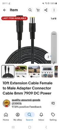

I think it's this one?
That lists the Jackery connector as DC7909 - that means it's the DC power jack series 7.9mm diameter outer 0.9mm inner.
That should find you a socket from that series. The adapter is listed as DC8020 if that's easier to find.
For example (not recommendation)
Great.
Found this one in UK, take it I can just cut off the male end and strip the wires back ?
You should be able to, just always be on the look out for cable where they actually state a specific current capacity or cable size - there are a lot of thick PVC jacket thin copper cables about and sometimes it's not even copper...
