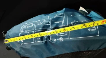

Decathlon one looks good, guess you can add some hot water if required too?Good price.
Yep normally fill up with hot water from a shower if on site, then use when out of the sea etc or for washing off sand etc.
@$immo. That Decathlon jobbie looks good - can you advise what sort of size it packs down to please (I'm assuming it packs down anyway!). Cheers.
It's about 30cm long and about 8-10cm thick depending on how well you rolling up. Pressure is good when pumped up. We use it to wash off when coming out of the sea, wash the dog off & wash up when off grid.
