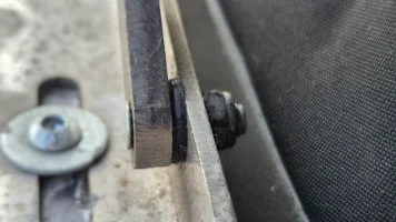

Has anyone else had the nuts and bolts holding their pop top scissor hinges together come loose? We were having problems pulling the roof down as we kept getting gaps at the back sides.Turned out it was because the bolts in the hinges had worked loose, so my question is… has anyone replaced the M6 10mm nuts on the hinges with nylock nuts?

I noticed that my roof looked slightly 'off centre' when it was opened and on investigation found that a couple of nylock nuts had worked themselves slightly lose so I replaced the whole lot (stainless steel from a known firm on eBay). Since then, I go around them every now and then to check but not needed to do anything so far (I also keep the right size ratchet spanner handy in the van just in case....). There are also nylon washers / spacers present on mine.
