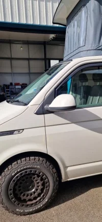

We have an auto t28 6.1 too, tyres and wheels where the 1st thing we done to start our conversion off :D we went for the goodrich bfgs for the same reason doing most of our camping offroad/muddy fields..we found them in the 235 size which give just enough clearance on the wheel arch...225 weren't big enough (our opinion) and everyone who gets the 245 say they rub on a full lock...I use my van as my day to day car (sold my Mercedes because same...the alloy cracked with these wonderful roads we have here full of potholes!!!) And honestly these drive fine, not as noisy as what ppl say and the ride is comfy...I think the alloys we have are called Fuel
love the van and great to hear you also use yours as a day van too. We opted for 16" Rogue Alloys, CC3 and General Grabber AT tyres fitted by Baja Customs one of the approved fitters for Rogue Alloys in the north. Living in North Wales, the amount of rain we get means a better quality of tyre than what was put on. I had no idea on the complexity of tyres and alloys until recently. I didn't notice any difference in noise from the new tyres versus the old tyres so that's great. Only just had these fitted on Thursday before the big storm rolled in.
