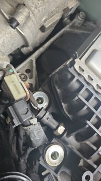

D DXX I have no opinion other than yours VIP Member T6 Legend 22 Jun 2023 #2 This photo is not from the CXEB manual but I suspect it is the same.
R Richtpop New Member 16 Aug 2023 #4 Wraner68/ said: View attachment 203103 Click to expand... Did you change this? did you have symptoms it needed changing? mine uses more oil than i would like and wondered if this might be part of the reason.
D DXX I have no opinion other than yours VIP Member T6 Legend 16 Aug 2023 #5 Temporarily fit a cheap oil trap in the system after the PCV and you’ll find out how much oil is passing.
D DXX I have no opinion other than yours VIP Member T6 Legend 16 May 2024 #6 Has anybody fitted a supplementary oil trap yet? If so; Which engine code. Engine mileage. Trap type. Trap location. Oil trapped (approx’ volume / distance).
