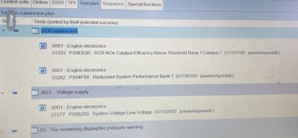

Hey @Hilly64 , Seems I'm having the same issues as you right now on my 17 Plate T6 150 Kombi with ~70k miles.
In December, after getting to the low warning on my Adblue system and filling up with a new batch of Adblue, I had the EML pop up after about 50 miles of driving. Explained the following to VW Assist the first time. I assumed it was related to the AdBlue crystalising on a sensor, ran some checks, reset the code and got back in contact if it happened again. Driving around locally, with no issues whatsoever, head across the country, and 300 miles into the drive, the EML pops up again.
VW assist calls out again, various checks, and two days later, the van goes to have a major service under the all-in plan as it was due and to look at the error code. Their initial thought was it was the NOX sensor / EGR clean / change pressure sensor 3. Advised me to book back in to check it all out in 2/3 weeks when they could fit me in. I didn't want to wait that long; I took it to a local independent who had found my EGR flexi pipe had completely split. They changed that, thought all was resolved.
After driving nearly 1000 miles, the longest being down to Newquay from Devon ~50 miles each way, nothing all seemed fine. Another long journey, 350 miles sticking at 70mph on cruise, near the same location, EML pops up. VW Assist called out the third time at mine for a good hour and a half, running through all their mobile test plans. EGR checked out to perform as expected and confirmed no loss of power, writing up the following on their breakdown report
Found p20EE00 - SCR Nox efficiency below threshhold, software up to date, checked flow throught EGR > all ok. Cyl 3 glow plug pressure sensor + cha required - TPI 2057802/1
Took the van to my nearest garage which has repaired a lot of T6s, said it could be a whole host of issues, similar to what you've had changed and they could start it but would advise if I didn't want to go down the route of repairs that they couldn't guarantee fixed it to code it out, which I don't really want to do.
Van is going into the local "Transporter" specialist garage that changed my split EGR pipe garage again this Friday as Plymouth Van Centre has shut down, with my only options being Exeter or Newquay to use the warranty / all-in plan that are not taking diagnostic bookings until April (Currently in discussion with VW customer services as Assist and two of their customer support agents have told me that due to the VW assist responding to my breakdown there should be a priority booking in < 3 days to any VW centre; otherwise they will face fines as they are not holding up their franchise dealership terms, but the dealers not wanting to take the vehicle in as it wasn't towed there)
I'll let you know the outcome of what the local garage says, to share if it could help, but it looks like I could be in the midst of what you've gone through, and then it's booked into the main dealer at the start of April before my warranty runs out at the end of the month...

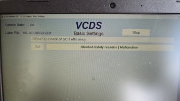

I would agree, my EML has come on 3 times with the P20EE code, the first time it was flushed and a new ERG pipe fitted, the next two times ( a year between) was whilst on the continent driving in very hot weather (once with the 650 miles warning). Both times I reset it and it never came back, whereas if it was a true fault it would surely pop up again.
on my VCDS I used the option
IDE04732 "Check of SCR efficiency"
After the checking procedure, everything is working as it should. (light went out)
Is this option available in the Carista app?
I'm going overseas soon and I wouldn't want to take my laptop with me, only the Carista cube.

It's an option in OBD11 so would be suprised if it isn't an option in Carista too.

Can anyone tell me why I can't do this procedure? 6 weeks ago 500 miles back I was able to do it and the amber AdBlue light went out. Now I have 650 miles left. Any ideas ?1000013933.webp
