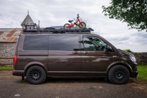

Might as well pull these pics into this thread too, and a bonus one. I do love these wheels and tyres!!:

And how easy is it to raise the ride height on STX suspension? Is it a DIY job?
How does it ride? I think it looks pretty spot on at that height - depends if you need more clearance or not.
It rides really well. Slightly less pointy than with the 18’s but that’s to be expected.
No rubbing. Just thought aesthetically it looked a bit low compared to others on this thread.
There is zero road noise increase from the 18’s.
Super happy I made the change.
