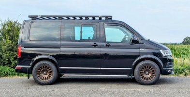

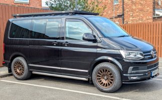

OZ Rally Raid in bronze
Falken Wildpeak AT3WA 245/65R17
On Koni Special shocks (not special actives), std springs, 25mm lift spacers, sitting at 450mm front and rear (thanks to the extra weight of the Caravelle).
