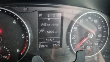

So ,like a bellend, i overfilled the adblue tank, the range is saying 6500 miles, and after a week to 10 days of driving its still saying 6500 miles, so i presume the sensors stuck

Ah, ok i see, thanks for the heads up, thats good, so when filling, if you do it with yhe range showing on the dash, is that a reliable way to top up and not overfill?
The range when full drops in 500 mile increments so unless you have done mega miles it goes down pretty slowly. Plus its only estimated usage based on your current/ recent driving so it doesnt mean it will align with your miles driven.
Good news is that it registered your fill up
Wait for the dash to read 600miles remaining.
