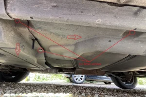

@mmi Do you have any advice on where to start with this?
Where is the sensor or the sensor electrical connection?
On the assembly diagram below I can see listings/part numbers for the pump and the control unit, is the sensor available as a separate part?

It seems you have had a good start by reading diagnostics data :thumbsup:
Perhaps next to check electrical connections from/to tank - for tidiness and signs of corrosion.
It seems that the sensor is not available separately. For more information see pp. 30-31 in below
