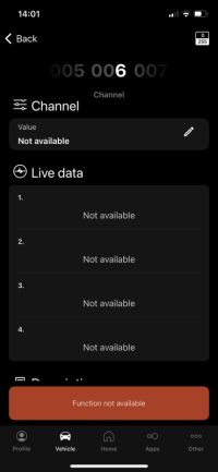

Hi Guys, hope someone can help me out here.
Just got an OBDEleven to update battery settings after installing a Bosch 95ah starter battery. I believe I need to go to 19-Gateway then Adaptations then onto the various settings functions.
However, I can get to 19-Gateway ok…
However when I click into Adaptation I just get the following…
IMG_0905.pngIt seems that whichever channel I select I just get a Function not available message.
Can anyone help with what I’m doing wrong?
I have a PRO VAG subscription.
Thanks for your help…
Sounds like yours is T6 ???, which has the function in controller 61-Battery Regulation
