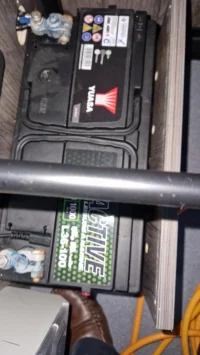

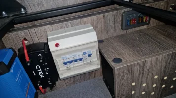

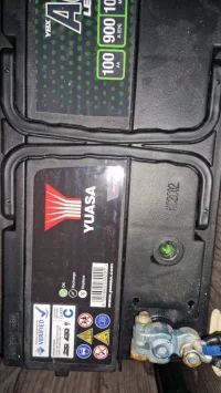

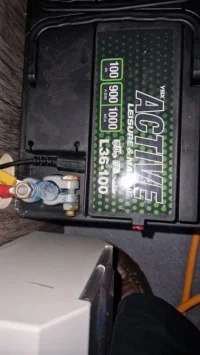

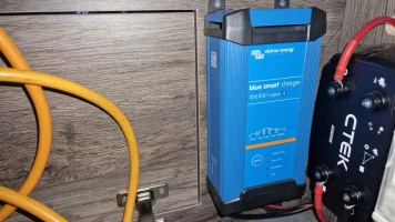

Some photos attached including the battery after I took the lid off its boxing.

So overall that looks like a tidy well organised install. It is the 15 Amp charger but that's reasonably matched to the standard lead acid battery. That's a Yuasu which is a well known brand.
Of note though is that it's one of the hybrid leisure starter types, hence why it has a cold cranking rating (900) which is quite high and an NCC class C rating. Those battery types are more for occasional use while on tour rather than sustained off grid. It also has an advised charge rate of 5amps which is rather low.
I have my doubts that that battery is matched to your desired use pattern though the good news is that the rest of the install would allow other battery choices if needed.
