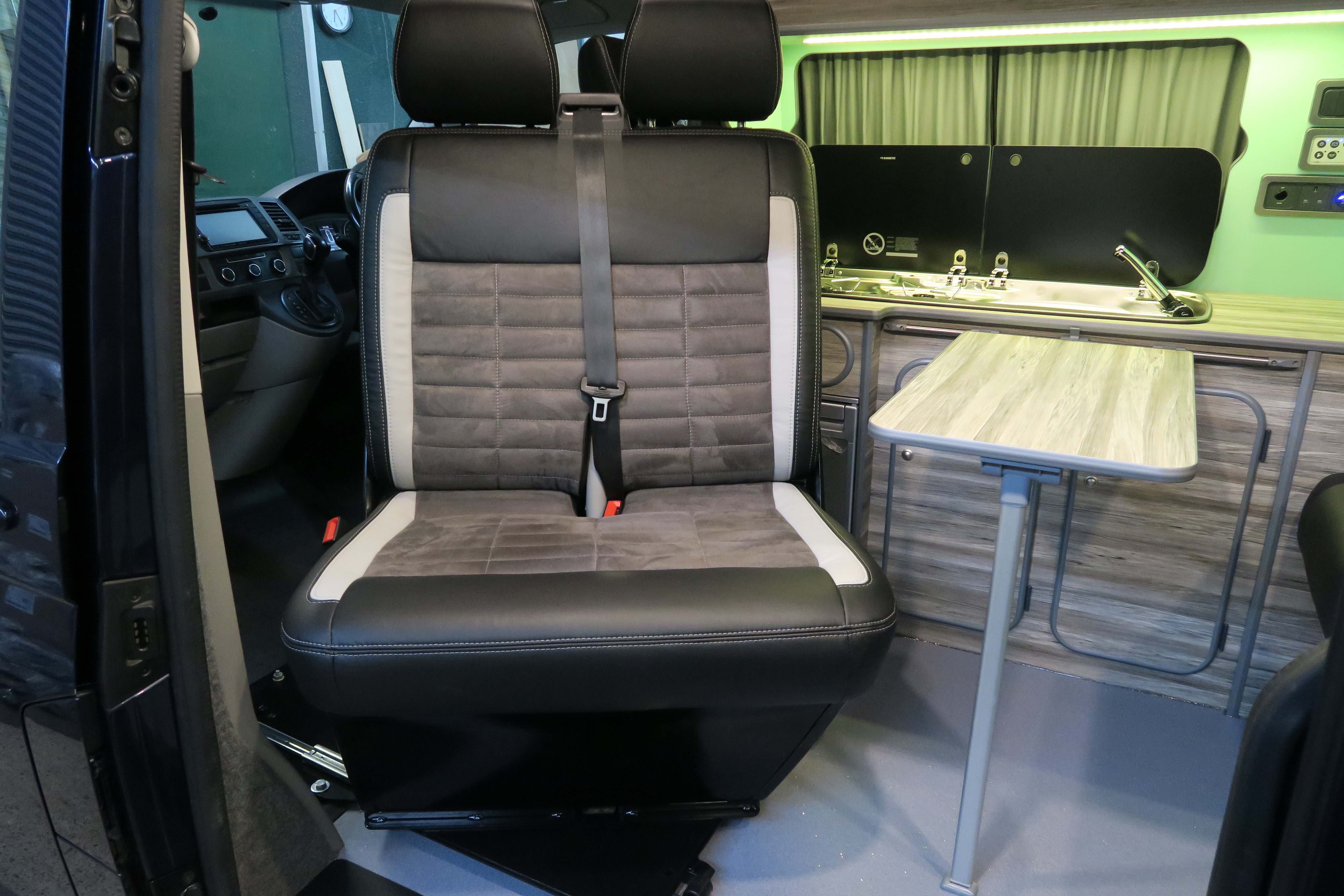

Hi. I’m new here and new to van life! Just purchased a T6 start line which has had a recent conversion. Not tested it out yet but have been trying to master the manoeuvres required for the features inside. Can’t figure out how to swivel the passenger seat xxx
Unscrew the four retaining bolts. Once unscrewed you need to pull them up and turn them a half turn until they lock in place. Make sure the driver's seat is pushed back all the way it can go. Then you need to manhandle the seat around in a clockwise direction. They're quite awkward at first. It's a matter of shoving it backwards and forwards whilst turning it. If that makes sense?

Welcome to the forum. There are loads of different seat swivels and they all operate differently. Can you post a pic of what you have and maybe we'll be able to help you further
If you tilt up the seat base cushion to access the storage under the seat are there more screws to unlock before the base can swivel?
