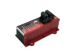

For a few years now, I have been using a Sterling Battery Maintainer and to date never had a problem with vehicle battery even after leaving parked for 6 months. There are others out there, but trust Sterling stuff.
