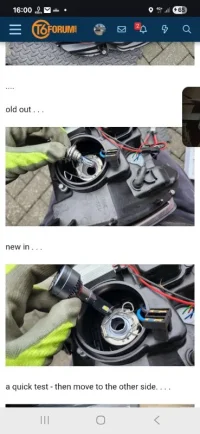

No, well not without removing the rear bulb covers.. .
As the LEDs are just replacement H4, H7, so the connector is inside the light unit hidden with the back cover.
Pics..
Cool, not an issue then. I wasn't sure whether there was room to fit all the gubbins out of sight behind the covers
