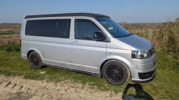

I had the GOJOS fitted to my previous van with BFG KO2s.
16x8 ET25 with spigot rings and tuner bolts.
The tyres were 235/70/16s.
7D3E5299-1AEB-4617-923A-DFDB0F95328A.jpegBCA5A3CF-03A2-46F8-BE1B-CCCE8B58077C.jpeg907F0381-E952-4189-B8B6-3B209120BEAB.jpegED01192F-D500-4129-A7C8-AEFA867C2187.jpeg190545CD-AE2D-4DC9-BBB4-9CF8EF1043A3.jpegCF6F0968-AA91-4E1F-BB8B-836701BE451F.jpeg
Wheels 16x8 GOJOS Black Modular 5x120 ET25 | Tyres Direct
Tyres 235/70R16 104S BFGoodrich KO2 RWL | Tyres Direct
Tuner Bolts 20 x M14X1.5 INTERNAL TUNER BLACK ALLOY WHEEL BOLTS FITS VW T5 T28 T30 T32 | eBay
Spigots 70.1 - 65.1 SPIGOT SPACER RINGS LAND ROVER ALLOY WHEELS TO FITS VW T5 T6 T28 T32 | eBay
