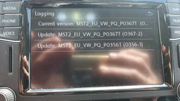

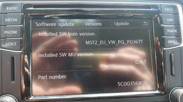

Instaled SW train version: MST2_EU_VW_PQ_P0367T
Installed SW MU version: 367
Part number: 5C0035680D
Software version: H28.28.197_STD2NavPQ_EU

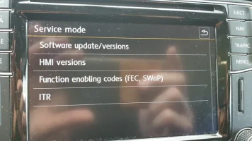

What does "ITR" means in service menu? (picture)
