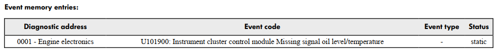

Well, it seems that also VW has a solution for missing oil temperature in T6 dash.
Can be found as TPI 2047638/3 (released 21-Dec-2022).
Basically the TPI tells that ECU software update resolves also this issue (the update which has been available since October-2019)
*) TPI=Technical Product Information
