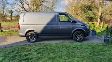

So I have had my T6.1 T30 HL SWB for 3 days. Love it. Just put my 20" wheels on it and now it need lowering desperately. I guessing about 60mm. It will be a camper when done and want a good smooth ride. So, what are my best options?20200306_153148.jpg

Personally I think that looks lower than 55 mm and if you went lower again I don't think it will look better and I know it wont be as comfortable ( unless of course you are running on standard shocks at the moment )
It is on standard shocks and the ride just bounces, defo 55mm springs tho
