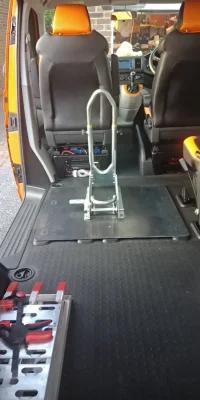

I made a plate up that fits into the middle row seat mounts that holds a wheel chock, the 690 fits perfectlyIMG20190526201022.webp
It's an acebikes steady stand.
I built a bike trailer a few years ago that uses three of them on a flat base, just unbolt off the trailer and bolt into the van if I only need to move 1 bike.
I fitted some short strips of unwin rail in the floor in the back luggage area and use the motoclix restraints to help keep the bike stable around corners and such.

I am currently doing a very similar thing, using a 5mm steel plate and mounting the front wheel chock and a 12 Volt winch. Picking up on the seat mounts and using 2 hooks and 2 threaded hooks also. Hope to have it all ready for welding next weekend. Will stick some photos on.
Great stuff, be good to see the finished job.
