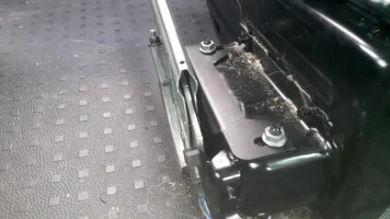

So, I removed the handbrake cover by using a flat head screw driver on the plastic catch underneath the lever. I spent ages trying to wiggle it off gently until I realised that a firm yank forwards is whats required! The lower cover simply pulls off. Until youre left with this:

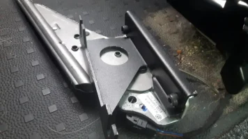

Next up is unscrew the 14mm bolts which hold the handbrake to the mount. The handbrake slips off easy. I left the auto-handbrake wire attached throughout with no dramas.
Using the bolts supplied with the lowering bracket i bolted the handbrake assembly to the lowering bracket.
The new lower bracket slip back into place on the original mount. A firm tap on the bottom of it got the two together nice and snug. Used original bolts to secure in place.

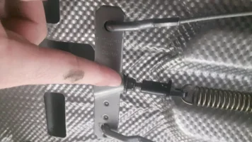

There was a fair bit of play in the cable so i tightened the screw on the handbrake until it would tighten no more. It was still a fair bit to go so i slipped under my van with a 10mm spanner and got to work.
This required a fair few turns until he cable was sorted.
