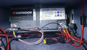

Just a thought, which may have been covered, when your engine is running have you looked at your bluetooth monitor to see what is going to your leisure battery. I would expect 14v or so and 10 amps or so especially as your battery voltage on the monitor is quite low on some screenshots. I think an earlier post you said that after a reasonable drive your battery was low voltage and fridge turned off with flashing lights. This is to prove your charging circuit from the alternator is working ok.
Then the solar charging issue, we are all just guessing as I thought the converters had changed the panel and controller already. They have decided they are faulty and will change so until that's done the same fault will keep occurring.

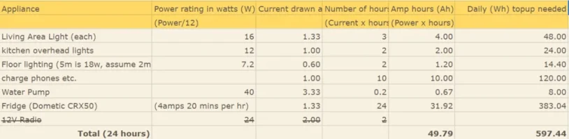

If I read your chart correctly you will consume about 50ah per day which has to be replaced by solar when off the grid (ehu).
You ideally want a panel/controller setup that exceeds this as you dont get perfect sunshine hitting the panel for many hours each day so the bigger the better in my opinion.
I have a 150w redarc panel on the roof and a 150w redarc blanket that I connect when needed and sometimes that only just replaces the power used, due to clouds and rain etc.

Re the flashing fridge / replacement of the panel and MPPT. We established that the reason for the flashing fridge and the other voltage drops (plagued me throughout November) was an unrelated issue. Basically, the converter had used "snap on" connectors to the battery terminal posts, which due to the number of cables did not "snap on" properly. The flashing fridge issue turned out to be the negative terminal connector had just "popped off" on its own (after I hit a bump on the road I imagine). The poorly fitting terminal connector led to some debate on the thread about whether that could be the issue with the solar too. I.e. if the connection to the battery is poor (as the terminal post connector is not on properly) then this could impact the solar charge. So, I replaced the terminal post connectors with the ones recommended further up (bolt on ones), and reset everything to see if that made a difference before the converter replaced everything. Alas, it never made a difference, so we are back to "converter replaces".

I would expect to see a decent current ( amps) reading when your van is running.
Ok, I was unfamiliar how his mppt was monitoring battery so that would explain zero amps all the time. Thanks for pointing that out to me, you always learn something reading these posts.Please note that @monsteruk is only using his MPPT app to monitor voltage. The current reading in this app is only for solar. He will not see the engine run charging on this!
Your BMV and app shows all current in and out of the battery so will show charging from all sources.
