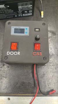

I have 3d printed a control panel for the new 12v lights which contains a battery meter, a usb outlet, tailgate light switch and cabin lights with a dimmer.
I don’t like the control panel though and I’m in the process of designing a new flush mounted one. I didn’t realise how much space was available behind the hardboard sheets. I think I also want 2 way switching
