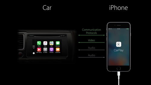

If you use Carplay or Android Auto, then the vehicle system is supplying the GNSS info to the phone. It is required to get Carplay or Android Auto certification.
Optional for wired and mandatory for wireless connections.
This is a slide from the Apple Developer web site ...
This means you need to ensure the GPS system of the Head-Unit is properly installed and has a clear view of the sky for best performance.
Everything you ever wanted to know about CarPlay and more is in this presentation from Apple.
This does not necessarily mean that 3rd party apps running on the phone will be provided with this info. Apple (and Google) requested access to the car GPS and dead-reckoning data to enhance Apple Maps and Google Maps navigation capability - not necessarily to make 3rd party navigation apps work better.
