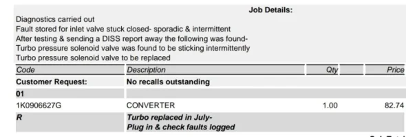

It was under warranty so I brought it to a local VW dealer and they replaced the full biturbo unit free of charge.
However the fault has appeared again and I've understandably lost faith in the VW dealer.
Was the new turbo complete with all the actuators or were they moved from the old turbo?
Was the turbine changeover valve solenoid (N529) & it's vacuum tubing ruled out - the middle one on top/above/firewall of the engine?
