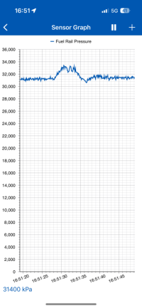

Logged the fuel rail pressure at idle and I’ve noticed the revs drop and the engine stutters slightly for a few seconds intermittently at idle, and managed to capture that in the fuel rail log. You can see the rail pressure spikes whilst I feel the engine hiccup.
Injector possible?
