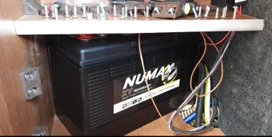

Re: battery location,
The model layouts vary - but if anything like the Monte Carlo (which sounds possible from your description) you will need to disassemble the rear cabinet.
Some images from before I got around to adding Solar:-

Thanks, pictures make for easier comparison of ways in.

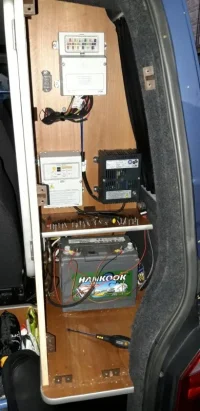

Another explanation I have seen (though once again a different layout to yours) :-
Ok I can see the top of one of the batteries (85A) below the level of the window and behind the panel with all the instruments and 13A power sockets, so I guess the way in is either to cut a hatch or to go in from the rear via removing the gas locker. Need to think this out.
