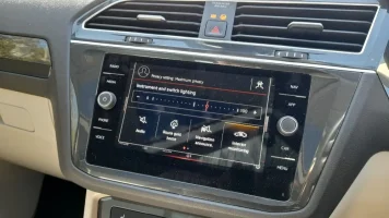

With reference to the T6 having a button to turn off interior monitoring on the T6, but the T6.1 having it hidden in vehicle settings;
If the T6.1 is like the Tiguan, you can add shortcut functions to the infotainment screen. Dragging down from the top of the screen opens 3 shortcut buttons. I've got the interior monitoring function, directions to home and something else that I can't remember on my Tig.
Ah, thanks, yes that’s the 6 vs 6.1 difference - the button just changes the ultrasonic monitoring meaning you can have that off but the deadlocks on - to do the same in 6.1 is a tedious head unit menu. I have the midrange head unit on mine and I've not found any shortcut buttons that are configurable, though I do have the pull down menu. Something else to investigate!

This is the screen on the Tig having dragged down the tab at the top that wakes up when you hove a finger over the screen.
