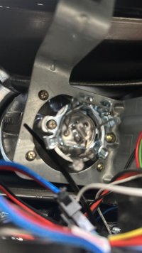

Hi this photo is the back of the full beam (H1 I am told) for an after market head light. I was able to remove the cable from the back but unlike the headlight bulb there is nothing to turn. Is there a clip or quick way to release the bulb? I can’t see this when I’m trying to feel around, I put my phone down to take the image.
Thank you.
There is a wire clip holding the bulb in. Try taking photos from a slight angle so you can see how it works.

Unfortunately that is not uncommon. Putting the clip back in place is very difficult without removing the headlight unit.

Have a Search with ’front bumper removal’. I find it’s far quicker to remove the bumper and headlight to change a bulb.
