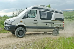

These Sports Homes are fab, much better than a motorhome made like a fiber glass tub.
The new VW Crafter is out, and from what I have read will take a big slice away from the Merc Sprinter in the leisure market with 4*4 etc etc, and Galvanised.

Would be great if the Crafter did come out with decent power and AWD; I saw a converted Sprinter similar to the one pictured on Galicia and really liked it but they are mostly only 2 berth.

If you go to the Dusseldorf Motorhome Exhibition which is at the end of August every year you will see these and Sprinter 4x4 vehicles for sale with different converters as ordinary M/Homes with more ability and some serious off road prepped ones as well, but as you say tyey all start at £90k and that was 2yrs ago.
