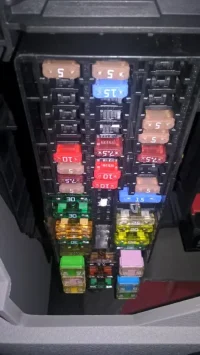

Interior and rear lights have gone out

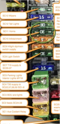

Became a vip member, downloaded fuse box diagrams and can I find it ? NO!
Go on where is it
Fuse 5 counting up from the bottom left
It's the 7.5a blade fuse on the bottom above the green square 40a fuse
