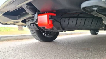

I just purchased a spare wheel for my 2016 T6. I’ve never had a spare in the holder so I thought it was about time I got one. I’m currently running 20” so thought as a get me home emergency wheel a 17” would be better. I saw a post on here showing that someone had managed to fit a 235/55/17 so I bought one from the wheel shop which said it was compatible.
2 issues. Firstly even with the front of the holding assembly lowered to its lowest setting the wheel just doesn’t seem to fit.
Secondly and most annoying it seems like the bolt has gone back in or came back.at an angle and possibly cross threaded and now won’t do up more than a cm, so for the moment I’ve put a bolt in the other thread to keep the holder closed.
Can anyone shed any light on whether this wheel should actually fit and I just need to keep persevering to get it in situ and finally what to do about the cross thread. I think it’s the nut part that’s cross threaded not the bolt to make it more annoying.
