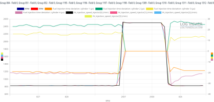

It’s pretty normal that some of them are positive and some negative. The overall sum of them is close to zero and they should all converge to zero with more rpm.
For comparison, see mine in VW T6 Custom PID codes for DPF
I don’t know if your values are exceptional though.

No need to take risks for this - parked and engine running, just flooring the pedal for couple of secs is fine. The range of my graph was just 6 seconds!
been trying to track down a bit of a rough idle….I logged injector time deviation at idle and then floored the accelerator and they converge to 0 but at idle not sure if the readings are off?
Deviation values on idle seem bit high as compared to mine (in example linked above my CXEB seemed to hover at < ±15us) but I’m not sure if it really means anything. Could be normal due to eg engine / fuel / intake air temperatures. Also what engine is this?

its a 150 CXHA DSG remapped. Basically I had a fly wheel replaced in February and I’ve gotten increased vibrations lately and the company are saying something must be Causing the fly wheel to rattle. They are saying compression test it and look at injectors. They maybe be right in that but just thinking vcds maybe able to point me in the right direction. No loss of power just vibration. Mounts replaced etc……
