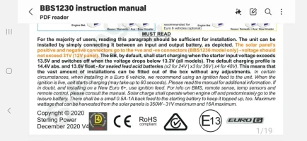

So bit more info - from the manual. see pic. Looks like i will try running an ignition feed wire- hopefully when engine is running while stationary in campsite it will kick the charger into charging mode. off to halfords for a piggy back fuse and then the fun of stripping out the whole front cab to run cable.

Sterling techs confirmed need an ignition feed wire to the DC DC charger to wake it up when van has been stationaryvfor a while. So it's a task getting a cable from the centre column fuse box across under the floor to under the drivers seat, ripping out seats, lifting rubber carpet etc.
