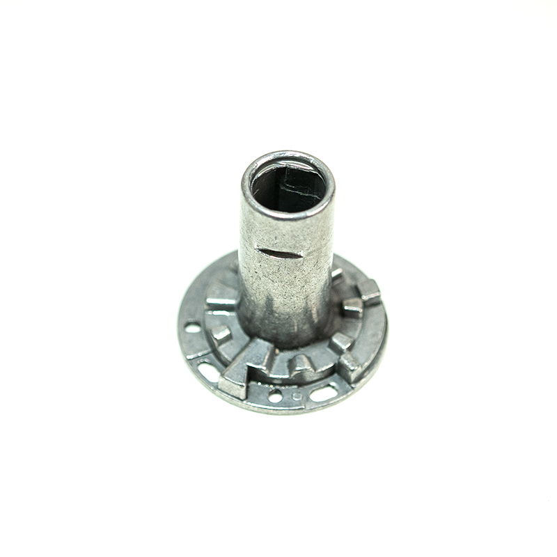

if it's not the cover, you might have a bent inner bracket/bush. I've just replaced mine after the wife knocked the mirror clean off! ;)
This is the part, a bit fiddly to fit but took my time and did it slowly.
UPDATE: I've just realised you have power folding mirrors, in which case... this bracket won't fit. :(
