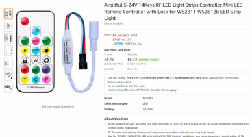

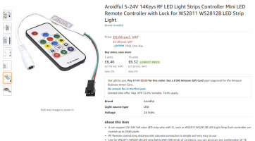

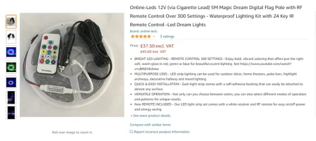

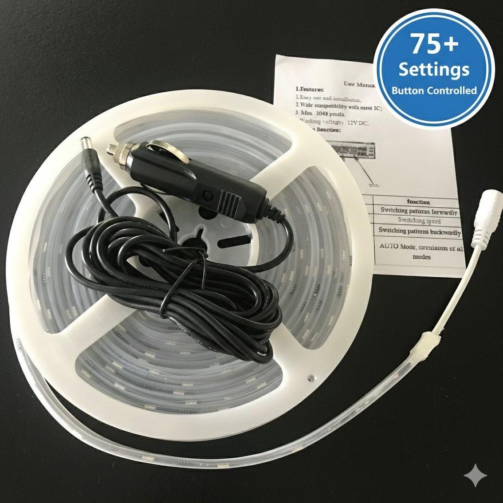

5m - all in one kit . . . .
cheaper here?
12V (via Cigarette Lead) 5M Magic Dream Digital Flag Pole with RF Remote Control Over 300 Settings - Waterproof Lighting Kit with 24 Key IR Remote Control -Led Dream Lights

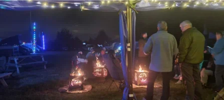

2022 Update . . .
it looks like the Chinese have caught up with things and giving @Deaky awesome LED setup a run for his money . .
this was T6F Autumn camp this year. . . .
everybody upped there game this year. . .
and one new product that caught my eye was @czmate1999 new Awning and Flagpole lights. . .
they were great and cheap too . .
so i had to get me some:

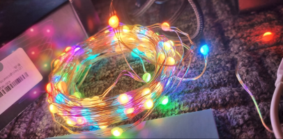

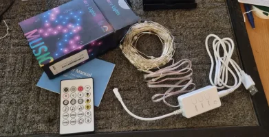

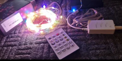

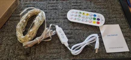

there was three types . . . this is the first one.
this is mine. . .

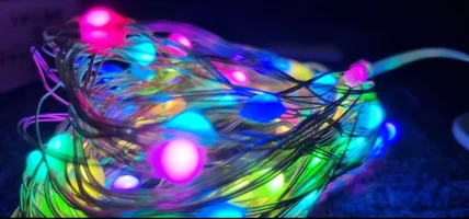

simple USB powered.
comes with IR remote and also BT APP.
these new ones are super tiny . . and waterproof. ( though the USB controller isnt obviously . . . we just put that in a zip-lock sandwich bag )

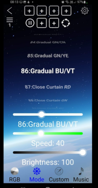

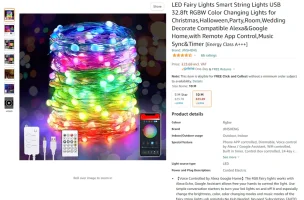

heres the APP. . .
donwloaded on Android phone or tablet . . .
the APP shows over 200 light shows. . .

we`ve been using these Anker USB power packs to run the LED strings. . . ( in the ziplock bag with the controller. )

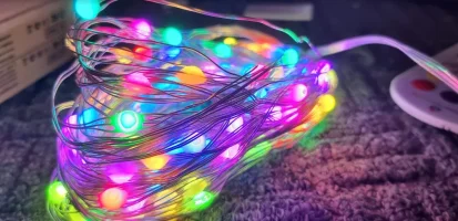

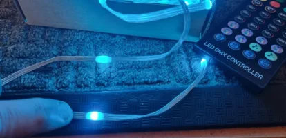

next is this unit . .
similar, but seems to be a bit brighter?
heres mine. . .
the controller can be used for on/off and modes. . .
there is an APP too . . .

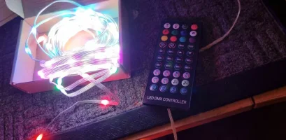

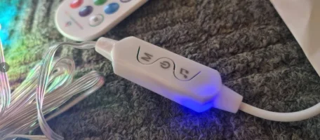

Next . . .

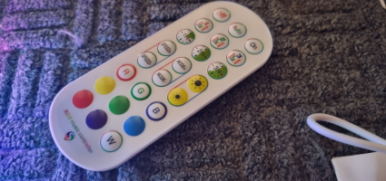

Similar again . . but this one has the nicest remote control.
heres mine. . .
nice remote . . .
similar controller. . .
and similar 3wire setup. . .

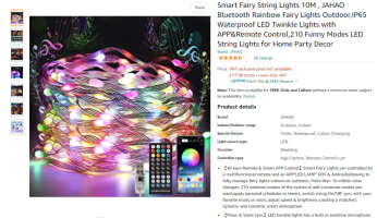

very colourful Dream LED string. . .
again we have an APP to play with . . .
