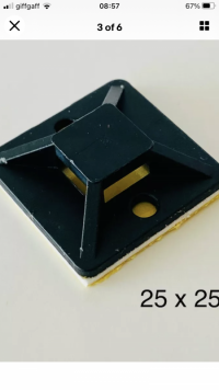

When you say epoxy resin doesn’t work, what are you trying to glue to the roof, the cables? I would use the epoxy resin to hold some cable tie clips, once set you can cable tie the cables in place AB889EEE-1A7F-4984-913B-BE7FFADC615F.png
Tried those using epoxy and VHB as well as setting the cable directly in epoxy. I'm thinking now that I may just leave the cable loose.

Using the cable tie bases as suggested above may may it it easier too.

Sorry mate, I've moved the van on. I ran them on the underside of the roof fixing them with electrical cable tie mounts (on sikaflex- I removed the self adhesive tape) and cable ties and then ran them in the spare grommet on the right side of the shut line (I had rear doors). I had to drill though into the van through the "second" skin.

Bit late but have got the solar panel on and all hooked up. If it helps anyone for ideas, ran the cables from the battery under the passenger seat through the “tunnels” space to the drivers seat, dropped out the van floor via the hole for me heater pipes, then along underside of the van with the plastic trays removed for access, then back into the van via the water pipe hole for the u def floor tank. Then behind the units into bottom of the wardrobe to the mppt. The panel slapped on with structural adhesive towards the back of the pop top. Looped the wires round the lower edge under the pop top roof. ( since pics taken I’ve stuck cable mounts to the underside of the roof and tied cables to them). Then ran them through the fibreglass mount so they’re on top of the original van structure and out the other side of the fibreglass support inside the van. Had to do a minor channel in the plywood for the bed for the cables then they go over the top and down the back of the wardrobe to the mppt. So far works as planned, fridge running continuously for a week and the battery still hasn’t gone remotely near flat, just needs a full test using the fridge so door opening and closing in warmer weather but confident it’s mission accomplished.
