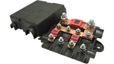

Can anyone suggest a high quality solution to expand my positive battery terminal connections - the OE terminal really can't take another connection?
I have a heated washer jet arrangement I want to wire in so need to add one more cable terminal.
I suspect a well protected busbar is the answer but you’ll need to check the current rating. There are battery clamps available with longer studs and others with additional screws. IMO its not a great idea to keep stacking cables.
It looks like the whole lot is secured with less than half the nut, not good.
Have a look at
BusBar or Fuse Box . . .
i went down the "main fuse box" route . .
BM2 - dc-dc, charger hook up, amp feed etc etc all from here:

Ah . . . I've found it . . . . classed as an ANL fuse holder . . .
bit its still MIDI fuses . . .
i used a master MIDI fuse inline with it . .
FWIW . . .
i took a main GROUND into the Fusebox too . . . from the Light bracket bolt. (paint cleaned off and connection drop tested all ok)
master fuse . . . . ( i need to re-do that at some point.)
The main fuse box . .
which all tucks neatly down here . . . .
then finally the battery cover . . .
