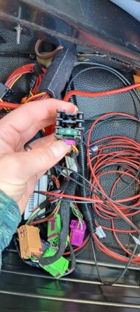

The 3 large red wires on the right of photo are all crimp soldered together and was bound together with a factory cloth binding
It has a factory tow bar fitted to vehicle

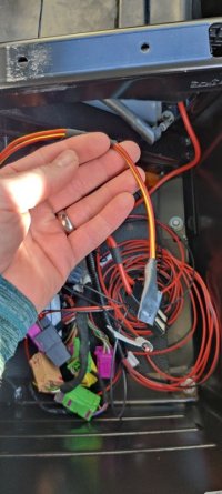

Just been out to vehicle. I have un clipped and pulled the large 3 red wires out. It now appears to be one red wire that is loop up to appear as 3. Now its in the open in full view its got a ring connecter on the end which would attach to positive terminal. it will runs to 60a fuse.
The 4 small red wires that are factory crimped together I think should not be linked to battery as they are live.
Think the best option now is to connect the now single large wire to battery which in turn will go to relay. Connect 2 earths back up. the 4 small red wires factory crimped together is insulate and secure safely. Finger crossed.

Where do those 3 wires go; to the fuse panel or under the cab matt towards the front of the van?
Do they have 12v?

Striped all out to see exactly what is what. The 4 small red wires crimped together showed 0.4 volts. they ran up to relays, so I reinsulated them and secured them to loom. The large red one went to the relay and +Battery terminal. The brown wire went - battery terminal to earth on body and earth from charging relay to body.
2nd Battery voltage was 12.6. Started her up and across rev range it was went up and down with revs 14.2 -14.7 volts so it is now been charged.

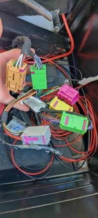

Does anyone still have an EX RAC T6 with secondary battery wired up? I stupidly removed the battery and RAC wiring without taking a picture first. Now I have a number of issues that could possibly be related. No connection to NOX sensor, No connection to particular filter and no rear lights (Brake lights work though). Any help is appreciated.
No battery is still connected at the moment it's just on the other side but I have had it in and out since I got it and haven't had any issues with lights, have you unplugged the other connections and not plugged it back in right?
The only connection I do have on the battery though is the positive and negative from the relay, I have removed the others and have no issues.
