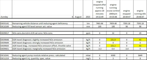

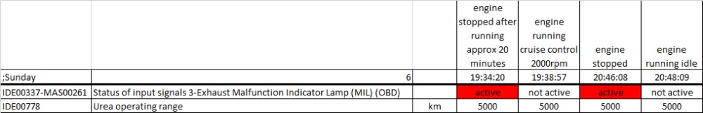

First of all apologise for long time to response , I was away for few days from home. I made a few logs of 01 and 17 , from begining:
- 1932 - 01 -engine stopped after running approx 20 minutes
- 1934 - 17 -engine stopped after running approx 20 minutes
- 1935 - 01 -engine running cruise control 2000rpm
- 1938 - 17 -engine running cruise control 2000rpm
- 2044 - 01 -engine stopped
- 2046 - 17 -engine stopped
- 2046 - 01 -engine running idle
- 2048 - 17 -engine running idle
Symptoms are similar but 'touch wood' 650 message not appear again, DPF re-generate every approx 200- 250km , is this is normal?

Thanks - very interesting...
Did you get emission light on dash - see the "active" below in log (after/during each mentioned run)? And cleared the faults in-between? What was the fault code?
Interestingly there is still some discrepancy of remaining AdBlue range between 01-Engine (below 7400 km) and 17-Instruments (above 5000 km).
Below in yellow NOx related values - which are different what I hav observed on mine. Mine registers only "marginally increased NOx" - all the other are plain zeros. I don't know what they mean exactly but they seem to be coincide with AdBlue discrepancy (between engine and dash).
The others are what to expect - e.g. indicated AdBlue pump pressure.

Answer to your question about malfunction, yes the lights(highlighted by you) were indicated because engine was stopped.

Thanks for the clarifications.
I would like to put more facts:
- dpf was re-generated approx every 120miles
Well, the expected lifespan of the DPF is maximum 300 tkm - so a kind of expected.
- after dpf cleaned process engine management light appear with below alarm:
32110 - Diesel Particulate Filter (Bank 1)
P226D 00 [100] - Damaged or Subrate Missing
Do you still get this fault? Is the exhaust tailpipe sooty?
33262 - Reductant System Performance Bank 1
P204F 00 [096] - Malfunction
31103 - SCR NOx Catalyst Bank 1
P20EE 00 [236] - Efficiency too Low
In the earlier logs there were as "intermittent" - do they still come back?
-Is this is normal that dpf is re-generate every 220-250km
Sounds normal to me. The DPF regen distribution below is what I have got. Anyways, the regen interval depends on driving style and especially how long journeys are. The longer the better.
-Any settings to be adapted /changed after dpf clean process to include removing unit from the the van, sensors etc.
In engine adaptations:
IDE07903-Adaptation of ash mass​
But it has been already done quite recently - some 3000-4000 km ago
Maximum 110 grams.
