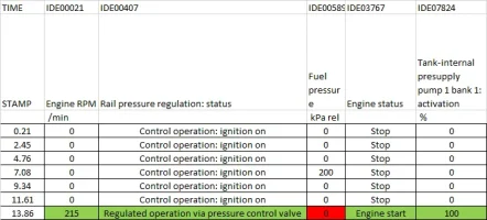

there was no fuel pressure - ECU did not even to try to fire the injectors (Main injection: duration of activation = 0).
Need to sort out why there is no fuel pressure build up during the cranking - the engine can't start without fuel.
The IDE00589 Fuel pressure should climb up above 30000 kPa instantly (something like in 0.3 seconds when cranking).
See an example in the linked post below

Hpfp? Can I test it using VCDS?
No, not really.
However, the control signals were correct for both fuel pressure controller and lift pump - in your logs - of course they do not guarantee that actual operation is correct.
Fuel lift pump can be run by VCDS -
VCDS > Engine > Output test > Fuel pump electronics
During the test the pump makes a distinctive sound (on left side of vehicle).
Some more details here:

Did you run the fuel lift pump - does it make audible sound?
I guess next would be to check that lift pump actually works - by checking fuel flow at fuel filter outlet.
There's fuel to the fuel filter and I can hear the pump.
That's good... hmmm... does this mean the high pressure pump needs to have a closer look???
Just tested on mine that actually (surprisingly) pressure produced by fuel lift pump can be seen at fuel high pressure sensor (in fuel rail).
Lift pump can be kept on by VCDS > Engine > Basic Settings > Test of Transfer Fuel Pump. Eventually the pressure "leaks" through high pressure pump and is (barely) detected by fuel pressure sensor.
Below the green is lift pump activation. Light blue sensor raw data (barely at low end resolution/sensitivity). Dark/thick blue calculated sliding average of sensor data.
If you want to try the same I can prepare a how-to?
