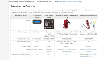

The Victron xs50 will not charge your batteries when temperature drops below a limit, so my eco worthy batteries are safe. You can also turn the charger off and me belt and braces also fitted isolation switch.
It does, but it needs a temperature feed from another device.
The temperature sensor for the Victron smart shunt also replaces the battery voltage sensors, and even then all it can measure is the temperature at the battery terminal. A proper BMS sensor will have the cell temps inside the battery. So it could be charging when the terminal is at 5 degrees but the cells are still below freezing.

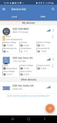

as above. .
The Victron Orion DC-DC ONLY detects temperature from a seperate additional device.
with my setup i used the Victron BMV712 Shunt with the additional TEMP sensor . . the temp was then shared via a local BT network so the Orion charger could get the temps.
1737222715485.webp.

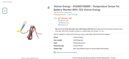

then i had to add this. . . .
same with the MPPTs . . . no Temp sensor.

as above. .
View attachment 271350.
