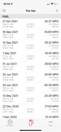

Hi @Ben100. I have a 19 plate T30 204DSG with full camper conversion, with around 5500 on the clock. It has mixed use - quite a lot of short journeys around town, and some longer stuff including trips away. I log my consumption through the Road Trip app and as you can see from the attached snap, my consumption varies wildly. A couple of these are skewed by my forgetting to put the info until a short while after I've filled up, but it's a pretty accurate picture. As you're 4M then you're probably going to be slightly more thirsty than me, but this will be compensated by your 150 to my 204. I think the honest answer is they're generally thirsty. I still get 45mpg out of my 14 year old 3 litre Merc with 165K on the clock on a run, and early 30s round town.

This is what we get:
Full tank averages are 25-35mpg
average fill volume @ 65ltrs
worst tank range: 304miles
best tank range: 507miles
average tank range: 400miles
