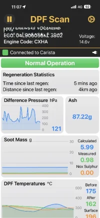

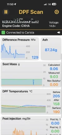

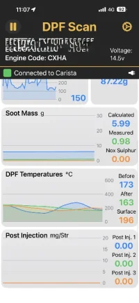

Hi, can anyone take a look at these and let me know if i should be concerned! The top picture is after i got home and the bottom 2 were as i was driving. It had done a regen just as i set off about 10:50am.
Thanks Sam
The Ash level is getting pretty high at 87.22 gms. Max is 110 gms when it will generate a fault code
Yeah i thought it was getting high, other posts suggest i still will get quite a few miles out of it, although i may look to find a dpf cleaning company
