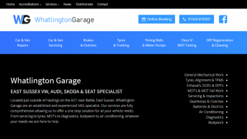

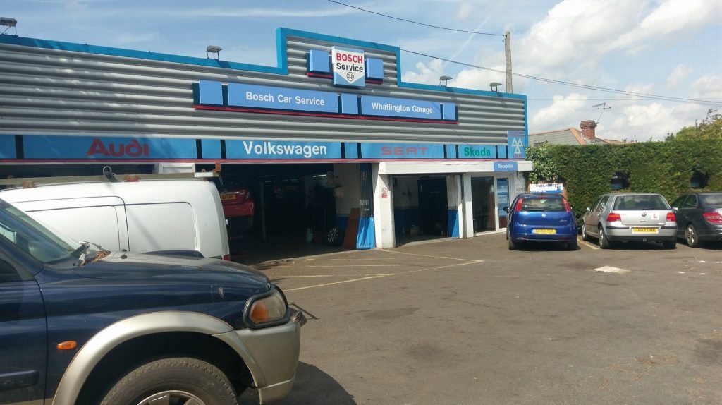

if you need help these VAG guys are local ish . .
