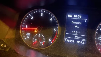

Diff lock warning light on, but I don’t have diff lock.
Bigsidavies
Retired
VCDS User
T6 Legend
I was driving along today no problems, gave the van a bit of a boot to get past a van and the orange diff lock warning light started flashing.
Van drives no different as I can tell.
Had a look underneath and all looks clean and good around the diff and haldex.
Turned ignition back on and light still present.
There’s is a similar post that was never resolved and the user hasn’t been on for over a year hence the new post.
I’m going to do a vcds scan tomorrow, but as I’m in the mountains of the Basque region it’s a little worrying.
Does anyone have any idea what causes this light to come on?

I guess I need to scan it. The cable is buried so I’ll do it in the morning and post a scan. Maybe clearing the fault will sort it. Hopefully a blip from putting my foot down.

So this morning the warning light isn't illuminated. Wonder if it got too hot yesterday going over the mountains.
Also,I had VW do the Haldex service at about 100k. It now seems highly likely that they didn't change or clean the filter so this filter will have 139k of crap in it.
That's job for when I get home as the Haldex service is due again anyway.

So a little update. After the fault had self cleared the other day, whilst driving along later the diff lock warning light started flickering like mad then going off then flickering etc until it became permanently illuminated again.
Just checked the van, which has been parked up for a coupe of days and light still on.
I’ll scan and clear again before I move off again.
Given the way the light activated I’m thinking wiring issue.
