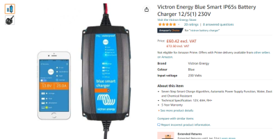

You need to install a battery charger that specifically uses the 240v EHU to charge the LB.
Many people, me included, use a Victron blue smart charger.
You can hard wire it into the 5amp rcd on your consumer unit and then connect direct to your leisure battery.
In the short term, or if you’re not happy connecting to the Consumer Unit, you can plug it into a normal 240v plug socket in the van and connect to the LB.
In fact, the wire from the Victron to the LB has a quick connect plug. So, you could wire the connectors permanently to the LB and then when in EHU just plug the Victron charger into a socket in the van and connect the quick connect plug.
Hope that makes sense.
One of these
Connected to LB using the ring connectors as in this picture.4C6B3393-93E1-49E9-82BD-653C9813296A.png

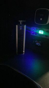

This is in the paperwork we have for the van but I don’t know what this is or where to find it? Thanks everyone
So that is for a battery charger, I’m guessing it’s not connected or switched on properly - any photos of your leisure battery?
So ctek is charging off solar. That’s good.
There’s nothing there to indicate how the Maypole is connected.
It may be plugged in near to your consumer unit but not turned on. Do you know where the CU is? Probably near to where you plug your EHU in.
Something like this
I can’t see the charger connected to the battery- it might be worth a call to whoever you bought the van from asking them where the charger is (it’s not listed on your spec), if it’s a permanent install you should be able to find it.
As above...
Looks like there is no battery charger connected to the EHU...
So it won't charge.
You need to add charger to the EHU.
If you have the maypole charger .... That's good. But I can't see it in any pics.
Or see any part of the EHU system.
More pics will help.
EHU connection point.
Consumer unit, 240v plug sockets etc etc ..
this looks like the EHU feeds the CU and then just the "Sockets" . .
so . . .
maybe the Maypole charger is connected to one of the sockets?
are there any hidden in cupboards?
if not maybe the Maypole book is a red herring and you havernt got one?
if not. . then as above, you need one.
