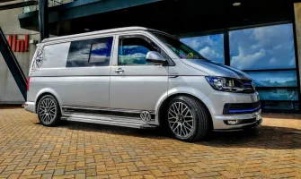

I've gone for 9.5 ET35 all round on mine (19" Judd T311Rs), and I have to say that the fronts are only marginally within the arch. The side wall probably projects by 1 or 2 mm but the year is within. Any lower than ET35 and is have had problems, but based on this I guess you ought to be OK with 40s.

I had ET 35 all round on a 8.5/9.5 255/45/18 and it was perfect. I had concave in the back. Depends how wide they are.
Cheers mate. appreciate the response and pics. Nice van and wheels btw.
