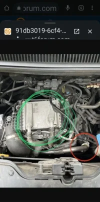

I’ll add to this thread instead of creating a new one, I’ve got low coolant today.
Looking in the engine bay there seems to be a bit of residue on this pipe in the picture. This pipe just carries exhaust gas doesn’t it, there shouldn’t be any coolant in that pipe?
This unit is the water cooled "charged air cooler" (green) (as @Loz mentioned above)
A possible internal leak, it will leak into the intake air stream so won't be noticeable externaly.
But will be evident on a leaked down or pressure test.

That charge cooler was replaced 2 years ago, you might remember the old one had a tiny split in the hose caused by the old charge cooler shearing it’s mounting. This one is the newer design.
The silver pipe I circled comes out of the EGR cooler assembly doesn’t it? I am wondering if the EGR has cracked and it’s losing coolant in there.
EGR cooler can leak coolant internally into the intake airstream via the EGR path.
