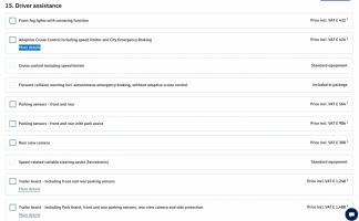

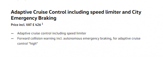

AFAIK T6.1 come standard with:
  • Cruise control including speed limiter
  • Forward collision warning incl. autonomous emergency braking, without adaptive cruise control
  • Leather-wrapped multi-function steering wheel (3-spoke)
  • Digital radio reception
  • App-Connect

Im sure mine has ACC though.
